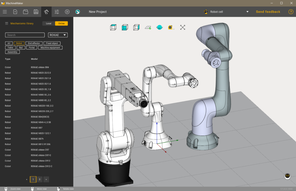

Added support for Kawasaki robots (BX300L model and others) in SprutCAM X and MachineMaker.
Support for 27 models of ROKAE robots has been added to MachineMaker. Kinematic models of these robots are now also available in the online robot library.
