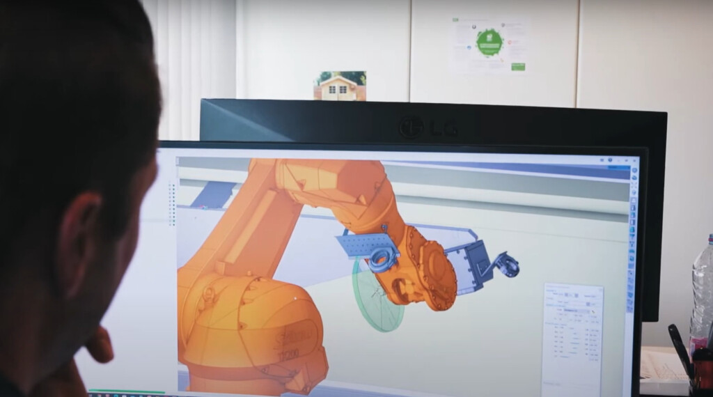

Solid company technical designer is programming the woodworking in SprutCAM X Robot CAD CAM system

“The machine produces a semi-manufactured product that we subsequently use in the packaging of garden sheds. A top we use to complete the shed’s roof section. And that calls for a finish that is very difficult to do by hand nowadays.
The technical designer uses SprutCAM X Robot to upload the technical drawings into a sawing scheme in the robot.
That way the robot can process the exact technical drawing to a semi-manufactured product that we will then process in the garden shed.”

They chose SprutCAM because the external linear axis is fully integrated, almost all cutting operations are done with the robot and the linear axis synchronised. The Axesmap was also a great added value: here, it is easy to change the position of the linear axis somewhat in relation to the robot to avoid any collisions, singularities or axis limits. As the customer works almost exclusively with saws, the Disc cutting 2D toolpath was also a great added value: here it is very easy to set the lead-in, lead-out and cutting depth.
Axes map in SprutCAM X Robot
Robot Axis Map function enables manually setting and fine-tuning the automatic control rules for the excessive degrees of freedom of a robot (the 6th axis, the rail axes, the rotary table axes).
