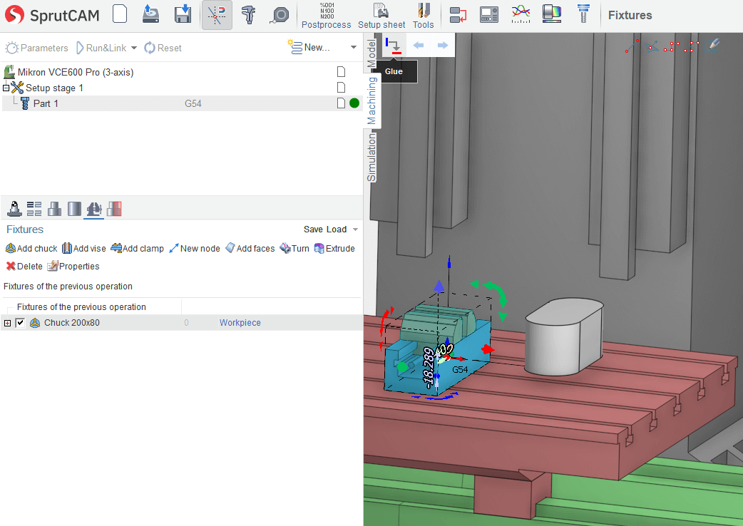

This update introduces the Glue menu when working with the snap-in. Now it is possible to position the fixture quickly and accurately in relation to the part. And place the overall assembly on the table of your machine.
Important: Smart Bindings must be enabled to work properly.
How it works

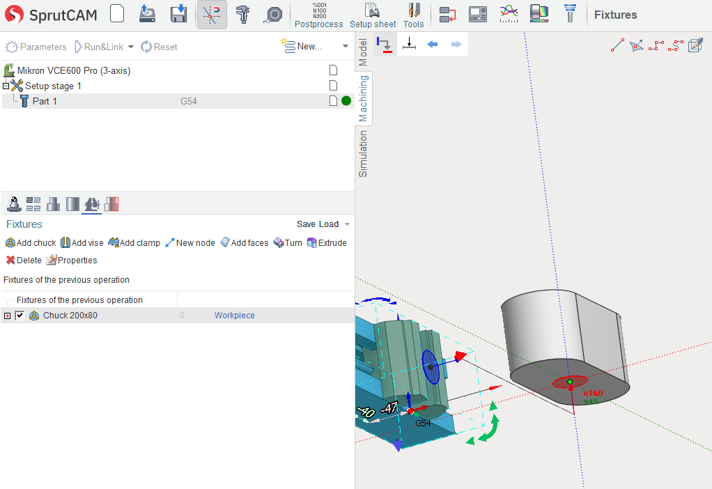

The blue circle indicates the first surface on the vise, and the red circle indicates the second surface on the workpiece to be mated. The vise will then automatically attach to the workpiece.
To set the exact position of the workpiece in the vise, first turn the vise 90 degrees, and then move the red dot to the center of the edge of the workpiece.
The blue dot is the center of the vise. Set the distance from the center of the vise to accurately position the workpiece. And also adjust the position of the jaws to the workpiece.
The blue point can be moved to any other location, for example, to the corner of the vise. And set the distance from this corner.

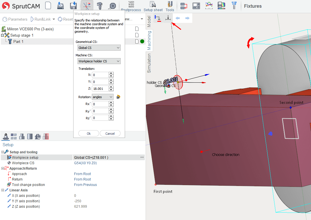

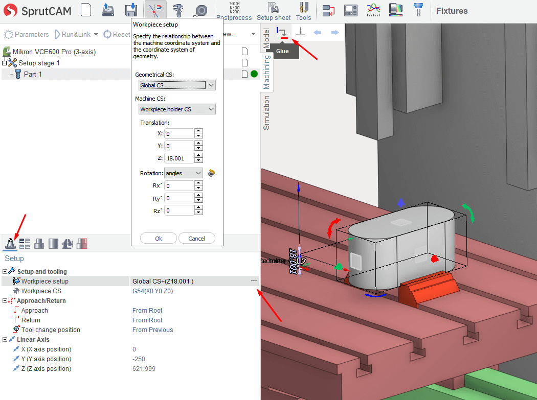

After that, go to the Setup tab and open a window with the Workpiece setup. This activates the Glue mode. In this way, the workpiece can be quickly positioned with the vise on the machine table.
The blue circle indicates the first surface on the vise. To determine the center of the vise, click on the Snap by two points and a vector button.
And the red circle indicates the second surface on the mating machine table.

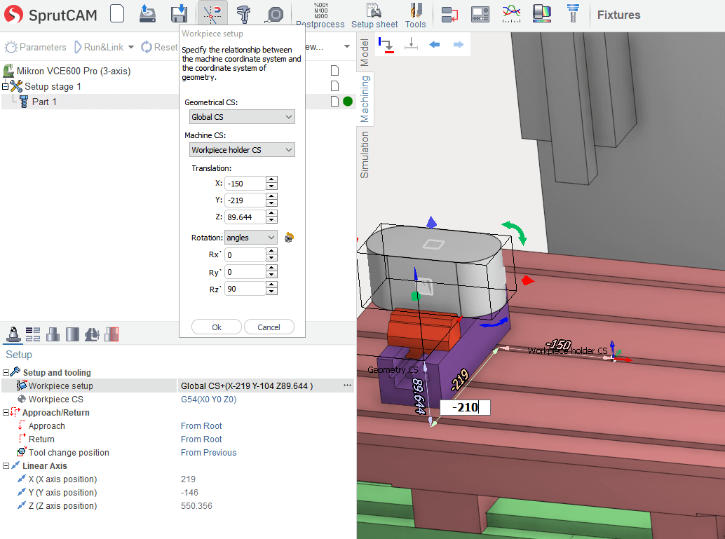

In interactive mode, fine-tune the position of the workpiece with the vice on the machine table relative to the center of the table.
Using the mouse, drag the workpiece coordinate system G54 to the center of the part. Smart bindings helps you do this.

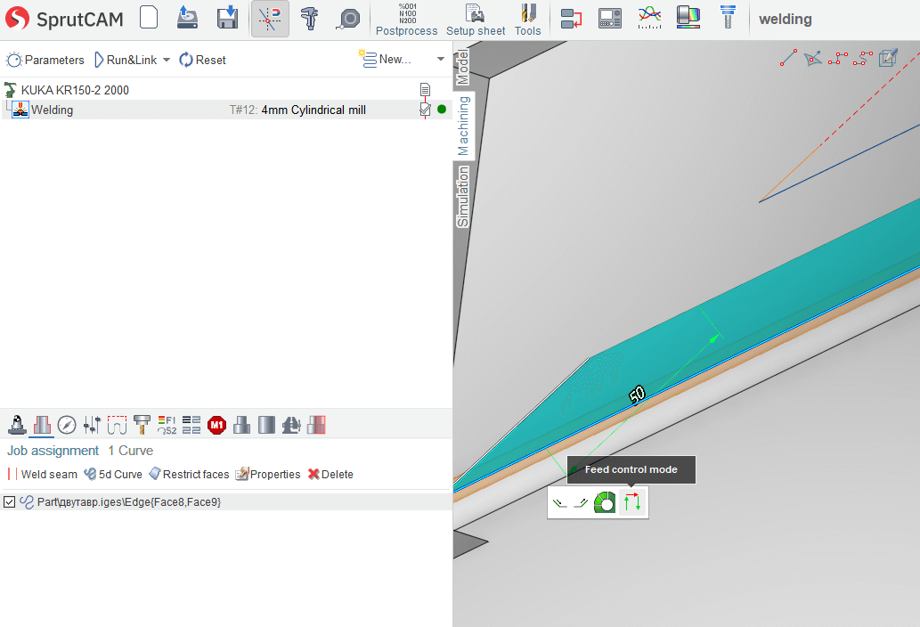

New in the parameters window in the feed control mode
We have special operations with individual settings that are required by our users. For example, this is often used for welding operations.
In this update, you can adjust these parameters for different sections of the path in feed control mode.
