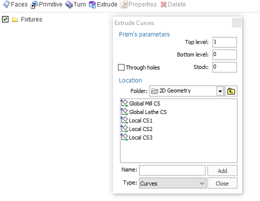

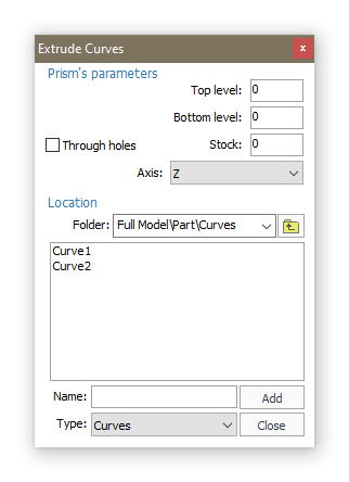

Updated the “Extrude by Curves” window for defining a workpiece
In SprutCAM, you can define a workpiece in four ways: load a 3D model of a workpiece, select one of seven primitives, rotate around an axis or by extruding contours.
The window used to be like this:
It became like this:
In this update, we added the ability to select the direction of extrusion directly when selecting a path.
