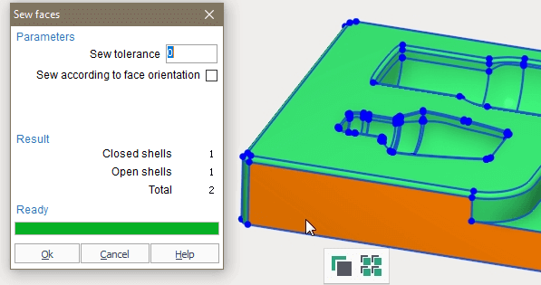

New functions in “Sewing faces”
Our users import 3D models into SprutCAM in such formats as step, iges, etc. Sometimes, it happens that during import some problems arise. Most often because of the 3D models themselves. Now you can deal with various types of problems while 3D models importing. Also, we added new features for the “Sewing faces” function in the interactive tools form. Find out more here: Sewing faces
