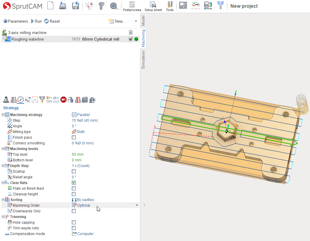

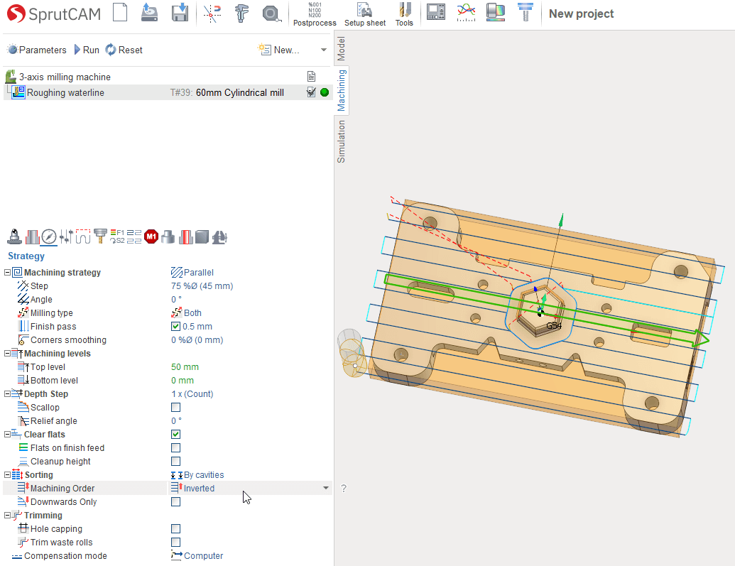

Option for parallel strategy: Machining order
Added an option for machining order for a parallel strategy.
If you are using this strategy for a finishing pass, you must select either Direct or Reverse machining order. Then there will be no different marks from the cutter on the surface.
Available for operations: Roughing waterline, Horizontal sections machining, Sampling, 2.5D Sampling.
Direct machining order – the cutter path along the surface will be strictly from top to bottom
Reverse machining order – the cutter path on the surface will be strictly from bottom to top
Optimal machining order – the cutter path on the surface can be either from top to bottom or from bottom to top
