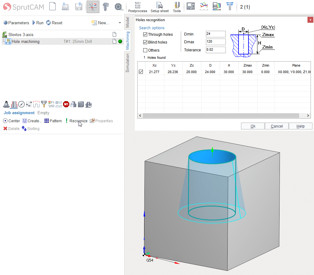

Recognition of conical holes
In this update, we added the ability to recognize a tapered hole in the Hole machining operation automatically.

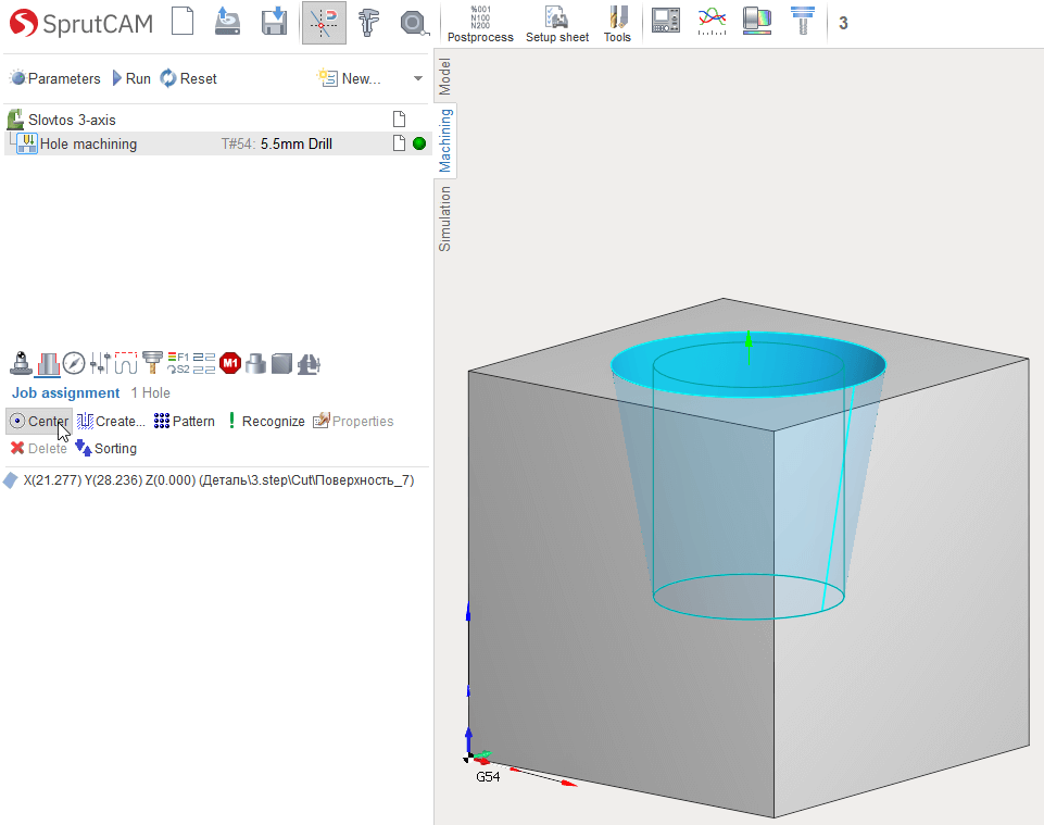

Also, the conical hole can be recognized manually. To do this, select the inner surface of the hole and press the Center button.

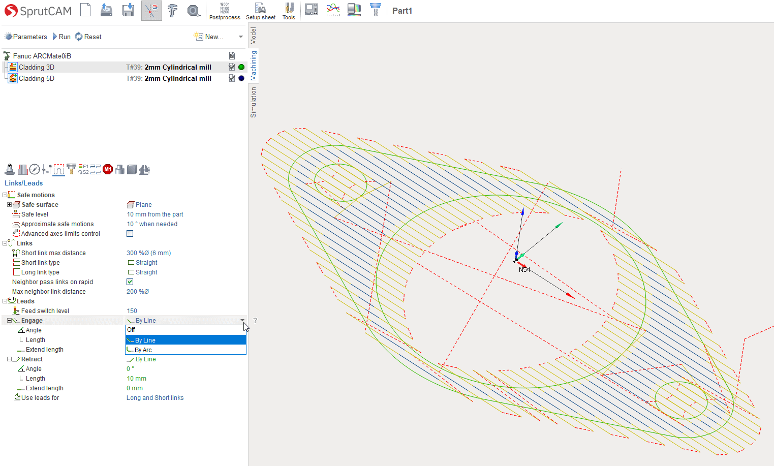

Engage and Retract at an Angle to a Tangent for 3D Surfacing
We have added 3D Surfacing to the operation engage and retract at an angle to the tangent. This need has arisen in the manufacture of items of laser welding of the powder material. In the screenshot above, this path is highlighted by yellow.
