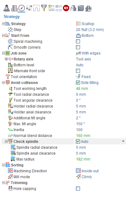

Spindle control
We’ve added new functionality for the “Collision avoidance” option. Now you can set the “Spindle control” parameter. Automatic mode and manual setting are available. This works for both milling and lathe machines. More details can be seen in the video:
This will allow programming hard-to-reach sections of parts much faster and safer for equipment.

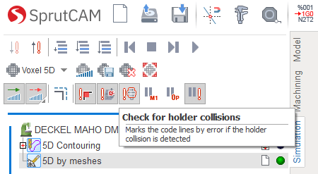

Fixed bug with collision control buttons
Our support drew attention to the fact that in simulation mode when simulation process is enabled, if you enable or disable holder control or machine nodes, then until the simulation is stopped, changes in the control mode do not work. Therefore, in order not to be misled, we made it so that while the simulation is running, these buttons are inactive. You can enable or disable collision control after pressing stop.
