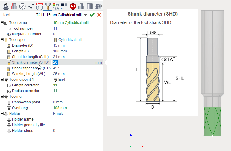

New parameters for the cutting tool
Now the shank for milling cutters and drills is specified in the parameters of the tool description. This is necessary to control collisions during cutting. Previously, this could be done through the mandrel description.

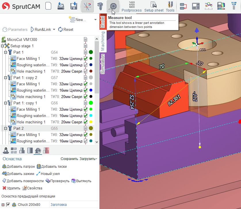

New in working Measurement mode
SprutCAM has a measuring tool function, which we call a Measure-tape. A Measure-tape helps you determine the distance between two points.
Now you can turn off the Measuring tool mode using the ESC key on the keyboard. Previously, to do this, you had to click on the icon again.
